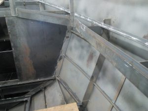

So after I hung the first two sheets, I remembered there was one other step I think I was forgetting... Oh yeah!, I have to cut limbers for drainage.
rough-cut limber slots.
Gotta remember that when the boat is upside-down, where is the steam going to rise to, even along the strongback.
After using the plaz to rough them out, it was quick work to dress then up a bit with the 4" grinder. No real time spent on these, they will almost never be seen, ... we hope.
dressed limbers
As of Friday evening, I have all four sheets I had cut out on Wednesday, all hung on the frame. I've been thinking I needed to drag my feet on this project, or I will run out of skins before I can get more sheet for covering. But I get so far each time I "just take a minute on it", that I think I have become addicted to this thing. Wow!, I hope that isn't a crime! If it were, I could go to jail for having fun welding, or worse yet, building a steel boat! I wonder if there is a "Boatbuilder's Anonymous"??? whooh, it has been a long week without farming breaks. I gotta take it slow on this recovery stuff. ;-)
Friday's assessment... not bad.

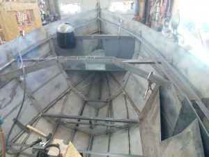

********************************************************************** 12 March 2016 Well, "next week" turned into a few months of Winter. I have been working on this young maiden for 2 weeks now this year. I actually was doing stuff with the drive system and the "power steering", throughout the Winter, but that will not be evident for a while.
Here are the latest pictures and I will explain them...
Fantail sides
Like the caption says, this is the last of the side skins to put on. It took a little bit of doing, but I made a smooth centerline up the back like fine lady's stockings. (Well I am calling it a "her"...) The plastic sheeting did well for these patterns, as the skins only curve slightly, and only in one axis, (mostly). I made patterns for the bottom sheets, but I found out too late, that the plastic sheet lays well on the frames, but when you are trying to lay the steel skins, they take on an entirely new shape. This is because although alluded to in the plans, the front frames #6, #7, #8, and #9 do not touch the skins except for each edge on the keel side and the chine side. Everywhere else between there, there is a gap. So a word to the future steel builders out there, cut this skin 2 inches too wide all the way around, and when you lay it, you can do a plaz-tack, plaz-tack process to get it in perfectly. Or, I guess you could do as the plans suggests and waste a couple sheets of cheap 1/8" luan plywood to simulate the curves and what the steel sheeting will actually do in the frames. Anyway, here is last week's installation of the Port side, front half skin. For the bottom, I got 4'X 10'' sheets and this will make it so I only have one lateral seam in the middle of the bottom, sorta....
I might add that I am skinning the bottom with 12 gauge instead of the 11 gauge called out in the plans. The weight savings is significant and the thickness loss is just .021" from the 11 gauge. Add to that, I skinned the sides with 14 gauge instead of the 11 gauge again called out in the plans. At this point, I have saved some 400 pounds that I need to use elsewhere. The only possible downfall is that it takes a bit more skill to weld down the thinner skins, and it is less forgiving of minor inconsistencies in the framing layout. So one has to be more careful to make sure ones frames and stiffeners are exactly right.

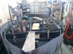

Starboard front bottom skin
Closeup of the temp tabs to hold up the skin
In these pictures I might note that I am a 1-man shop. So I have some stuff I do for ease of working alone. Since the left is exactly the opposite of the right, I took a pattern from the first sheet, after it was installed, and made a perfect match for the other side. Then, since there were issues with putting the skin down into place, I put this one on backwards. That is to say, I clamped it at the bow, and in the other picture, you will see that I had it resting on 4 temporary tabs. Then I could get the bow welded into place, using the weight of the sheet to help lay it down as I moved back with the tacks. On the first side I started at the back, and by the time I got to the front, I had two 1-ton come-a-longs (with welded-on pulling rails) and a 2-ton porta-power jacking on things to maintain the keel line, and pull the bow into place. I can't imagine what it would have taken if I had built it with the 1/8" (11 Ga.) plate called for in the plans.

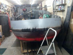

Then first thing this Saturday morning, I finished welding in the waist rail, and started on the fantail bulwarks. So the above picture has the fantail bulwark sheeting installed, too. If I were instructing anybody else to build this boat in steel, I would tell them NOT to install this sheet until the hull is righted. That is because it is really hard to get the proper shape to the curved sheet and maintain the proper radius on it, too. And I was only dealing with 14 gauge here. I would never have been able to man-handle 11 gauge sheet here by myself. So next, is to finish the mods to the aft bottom between frames #1 and #2, and then skin them. I will do a number of pictures for this in the next couple weeks. Since I am also fabricating the "pulse-fusion reactor" to mate with the "caterpillar drive," I will be working on those parts next. One of my "reactors" arrived last week and I am excited to get it mated up. Man! I can see why "Emmett Brown" had to make a deal with the Iranians to be able to afford his creation (just funnin'...).
View from Above the aft.
This is what it looks like as of Saturday Evening the 12th.

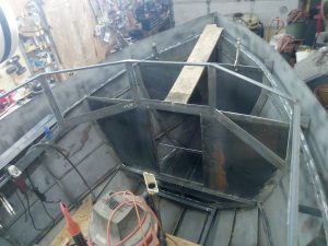

But seriously, I will be working on the propulsion and steering systems and how to incorporate them into the hull, next week. *************************************************************************************************************

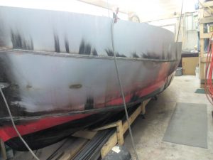

27 March 2016 -
In the past 11 days, I have seen the finish of the bottom and sides, checked and dressed welds, and started again on the drive system construction and installation.
A couple of notes here: 1, I thought at this point, to list and display what might be called "A few of my favorite things", (a phrase from Sound of Music).
2, In talking to my most trusted Marine Advisor / Plans Administrator, I am opting to come clean about the drive system, and put my ideas out for all to see. I would ask that if there are constructive, positive, and productive helps in the readership, I welcome them. All others relating to this topic, please hold your comments until I have posted the maiden launch.
So here goes ...

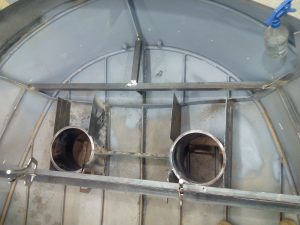

OK, now onto my "secret drive system."
While consulting with my most trusted "Marine Advisor", (that be you, Gayle...) it was concluded, that the readership would be interested in the drive system (without antagonism), with the very clearly stated caveat that, ...

Here are the progress pictures of the hull sheeting.
Tacking skins amidship.
Aft bottom skins going down.
Patterns were a bit rough for the placement.
..., But a little bit of re-glazing and grinder work.
Both sides in place-ready for final welding.
And here is what it looks like after welding and grinding. I still have to cut and install the bulwarks skins, but wanted to get the stiffeners welded in a bit, and these skins would make it extremely difficult to get into the inside if in place beforehand.
Bulwarks left to place.
Aft done including fantail bulwarks.
Sides and bow done except for bulwarks.
Till next time, ... ++++++++++++++++++++++++++++++++++++++++++++++++++++++++++++++++++++++

And so here is the culmination of the month of work...
Finished cut-outs, ready for barrel assemblies.
Now that I have a sure placement, I will be removing them and finishing the construction of the inner turret barrels and the final assembly of the parts to make them complete and functional steering turrets.
View of turret offsets in finished dry placement.
Finish fitting of turret assemblies prior to welding in place.
As you can see from these last two pictures, when they are finally welded in place, they will get a bead on the outside of the fairing/hull contact point, and an inner bead on the barrel hulls penetration point, thus making an air & water tight cavity that will not be accessible after assembly as noted before.

9 September,2016 - Evening...
Well, this is going to be a bit shorter than the last entries. What with working on the roof of a widow lady in our church, and brushcuttin fields for fall (and church on Sunday of course), I only had 3 days to work on the tug.
Port side, forward Bulwark skin going on.
So I got the final bulwark skins welded in place, and after buying ANOTHER grinder, (a bigger one), I have all the outer grinding all done. I found a new Curtis controller on eBay, that was the exact model I needed to drive my "traction" motors. It was well priced, so now I am halfway there on the motors and controllers to drive it.
So here is what it looks like this evening:
All the outer hull skins welded and ground smooth,... Wahoo!

8 October, 2016: I got the black on the bottom, but it was a mis-judgement on my part. I got it covered, but it was not up to the quality I usually do. That is vague-speech for "I got a couple hangers and a dry spot in the finish."
Bow, primed, waterline marked.
Stern, primed, waterline marked.
The black is on, but not pretty.
So I fixed the flaws with some 320 wet-or-dry, and ordered another pint of Chassis-black Topcoat.

Looking aft over the port bow.
Aft looking forward.
Turret barrels angled slightly forward at tops.
Turret barrels angle slightly inward at tops.

This left the area between Frame #9, and frame #8 for something, ... something, ... what could I best use this vital and odd shaped 22” (by an average of 60”) of bow for, that would be right and proper to the new owner? (Now remember this was going on for a week.) After some prayer, and more contemplation, and research, I finally decided it might be the best place for my auxiliary diesel gen-set and shore power charging center.
Generator room sole floor framing.
So by the end of last week, my (did I mention at this point it was partially burned up!) little tug boat had an “anchor stowage/forward rope locker” and “Generator Room.”
Anchor and rope locker framed in.
Rope locker and generator room w/ bulkheads.

Boy, I was on a roll. I also had planned to construct only the lower 4’ of the wheel house, up to the bottom of the window line. Anything above that, and I wouldn’t be able to get it out of the shop’s 8’ door. I am NOT going to do an “NCIS” moment.
Several 4' sticks of 1"x 1"x 14 Ga. broke for wheelhouse front corners.
Lower wheelhouse framing done.
Another angle of the front wheelhouse framing.
A final note about my wheelhouse. It is 5'-6" fore and aft, by 6'-2" wide. That makes it so I can design and install two convertible bunks on the back bulkhead for those "overniter" jobs. The bottom one can also be the back bench for crew seating during the day.

As I progressed further towards the end of the first week, I found myself wanting to build the structure to support the 11 Ga. aluminum fore and side decks. And by the end of that last week in January, I had the framing all in.
Deck support framing.
It was now time to clean up, and shift everything to the front half of the hull, and begin the back half. The back half had its complexities also, and I had to juggle and crawl through the bilges to complete the welding.

Oh yeah, I almost forgot, ... here are a couple pictures of my burned up paint job.
Burned up bow.
Burned up stern. Nothin I can't repaint...
I guess it goes without saying, at $80 bucks a pint, I want to keep these kind of mistakes to a minimum.
