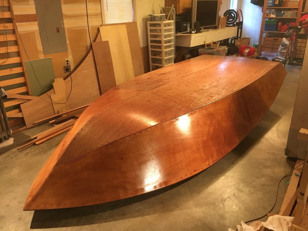

With the boat upright and the deck not yet installed, it was easy to get access to the interior of the boat in order to seal the wood. Two part penetrating epoxy was used for this job and after a few layers it looked great and will hopefully provide protection against water, dirt, and scuff marks for years.
The 1/4 inch plywood hull is strengthened and protected with a single ply of 7 oz fiberglass cloth. After curing, multiple coats of resin were used as a build layer so that the surface could be sanded to a smooth finish without cutting into and damaging the fibers in the cloth. I made sure to remove amine blush contamination before sanding the resin.
The next step was to prime and paint the hull. First I tried using Interlux Brightside, a one-part, air-cure paint. For one reason or another, I could not get the paint to cure properly, it remained tacky even after being left for a week. I must have made a mistake with the temperature, humidity or thinning of the paint. After two failed attempts I switched to Interlux Perfection, a two-part, chemical cure polyurethane. This worked flawlessly and looked great after three coats. The skeg was mounted after the paint had cured, and was sealed with penetrating epoxy.
