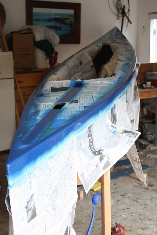

Yeah, I used Pre-Kote and Brightside...
I let it dry for over 16 hours, sanded, wiped down with brushing liquid and then overcoated as directed.
The only thing I can think of is that the wipe down with 333 might have done something to liquify some of the thicker areas of primer again, and maybe I was painting the blue over some wet primer.
At least it dried hard, and I can sand and try another coat of brightside this weekend if they temperature stays up.
On another note, I got an air compressor for christmas, and I thought about spraying instead of rolling but I didn't want to deal with the chemicals in the air since my Garage is basically attached to my bedroom and I don't have a full face respirator, only the twin cartridge type.
That, and my garage barely fits that kayak diagonally, so it would be pretty hard to spray.

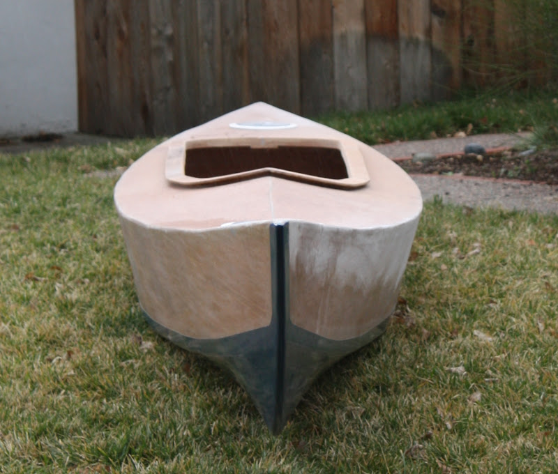

I bought the Harbor Freight gun, but still haven't used it to paint... I messed around with it to get it tuned up, and my garage and house was so full of fumes I decided not to use it (I have a gas Dryer with a pilot light in the garage too)
I painted this all with Roll and Tip, and the second coat came out much better. I still think I need a third coat, but since everything on the sides looks good I figured I'd leave it since the bottom will likely get scratched anyway.
So, here's where I am. The coaming is on, but I still need to do some shaping. I need to paint the strip on the sheer which will cover about 2 inches on the sides, wrap the sheer and continue 2 inches on the top deck. Then I need to varnish the deck and the bright strip that will be left on the sides.
So, my little 1.5 week project continues...

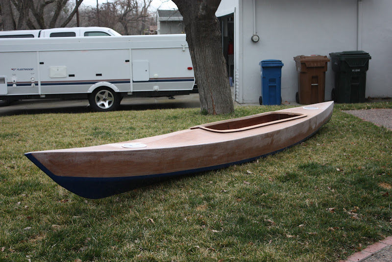

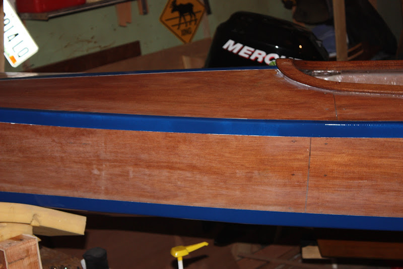

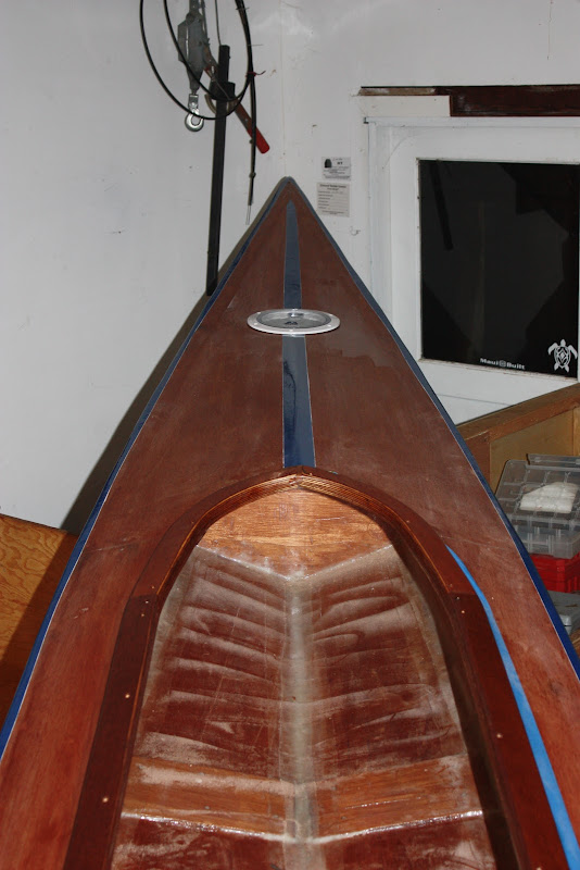

Well, here's an update:
I'm painted and ready to varnish the bright areas. The sides are glassed, but the top is only encapsulated.
I think I had a bad epoxy mix ratio when I encapsulated the coaming, so I have to figure that out, then varnish the bright part of the sides and deck.
BTW - The Harbor freight gun worked great, but I laid it on a bit heavy... For my first spray, I was very happy with it and it looked much better than the rolled on bottom paint.
If it ever stops raining on the weekends out here, I'll get some full length shots:
Oh yeah, and the inside looks funny, but the lines are just from the dusy that my vacuum couldn't pick up. I need to clean that out too.
