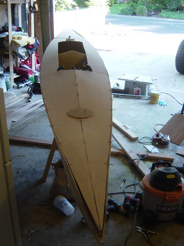

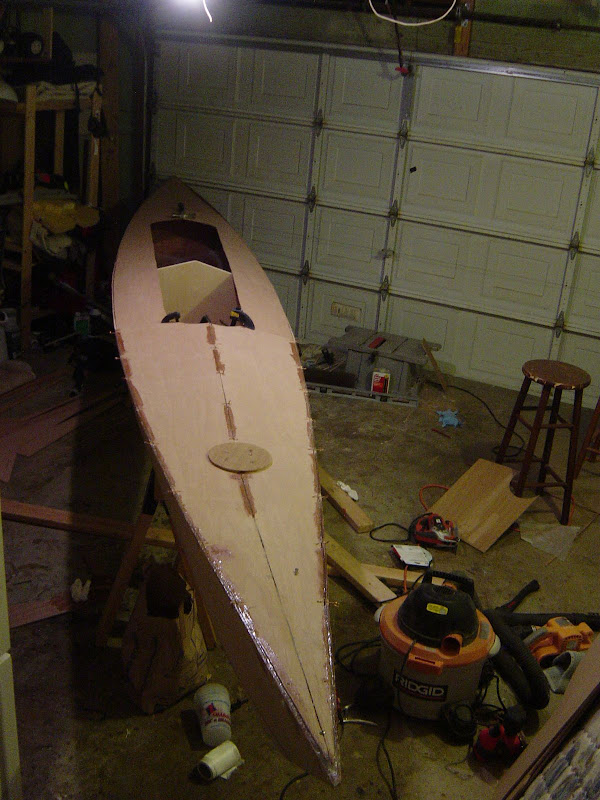

Alright, so as i mentioned, I really hit a wall, but here's where I am at...
I always try to epoxy something every night before I go to bed, since that is the best time for glue to dry without much down time so I stitched the front deck in place this afternoon, and tacked it not too long ago. Also keeps me motivated.
I'll pull the stitches first thing in the morning, try to tack the mid-decks before I go to work. Then come home and pull those stitches, and work on the rear deck.
I am hoping by Wednesday night I'll have the deck fully glued in place, corners radiused, faired, and ready for interior fillets and exterior glass.
The exterior tape and glass is the step I am dreading the most, but I usually find that if you mix the epoxy, it kind of motivates you to get stuff done. I also didn't anticipate the cost. It looks like the exterior cloth is going to run me at least $75 and I am running up on my wife's imposed credit limit for this month.
Another big thing I realized is that my wife's car can't carry the Kayak, and my Jeep CJ7 can't either unless I go with no top, and rig something up so I might not even have a way of getting this thing to the water!!!
Anyway, here's the latest pics. Fortunately, I am not worried about my deck/side planking seams since I plan to paint most of them and over the seams:
I should be able to clean up the chine and keel lines pretty easily. Not too bad, but definitely needs a date with the belt sander for some fairing.
Stitched
Glued

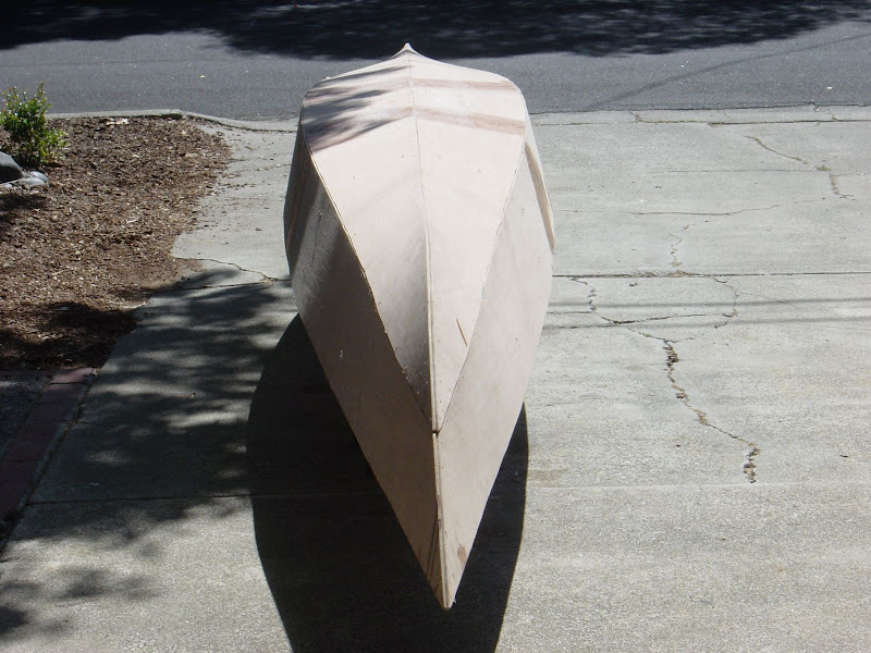

Buttoned Up!
Post by boat-bill-der »
I tacked the whole deck in place and attached all the butt blocks last night and removed the stitches this morning, so my deck is on! I still need to fill the gaps where the stitches were, fillet and tape the bulkheads inside the cockpit so that the compartments really are water tight, and I think i'll tape the deck to the sides from inside the cockpit, but not inside the compartments.
I am going to cut out and attach the coaming today, trim the deck to the coaming (i left it oversize, meaning the cockpit is undersized as per the plans)
I see a lot of sanding in my future!
I would love to get all my tape on tomorrow, then start glassing friday after my last day of work at my current job!
Sheer Seam Stitching, looking aft
Forward Bulkhead looking from the rear of the cockpit
Rear Bulkhead from the front of the cockpit
Top view with all fasteners removed
Nice sharp bow lines
Closeup of butted seams and cockpit
