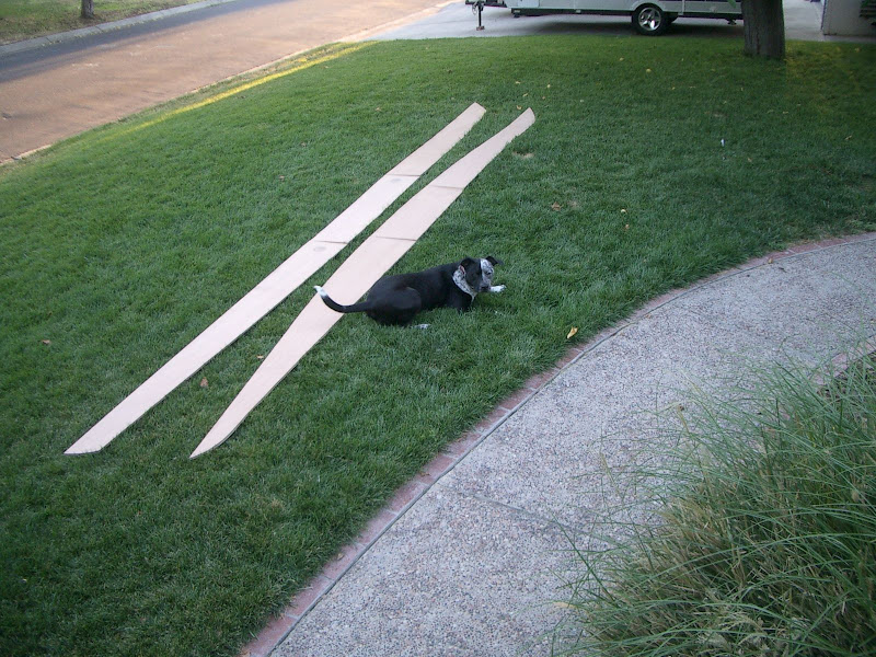

So I started this morning with a budget of $750 and I am at about $450 so far...
Here's my summary:
Plans and copper Wire - $136
1/4" Hydrotek Plywood - $160
These stuff is wall way cheap b/c I work @ West Marine (Saved $218 according to my receipt)
Total: $166 (would have been $380)
- 1 Gallon - West System Epoxy Resin, Hardener, Pumps and 503 Filler
- FG tape
- FG Application Tools
- Deck Hardware (Eye bolts, Shock Cord, Shock cord loops)
- Assorted Fasteners and
I still need FG cloth and more epoxy for the outside and paint, but I think I can still stay under budget and I think I'll be able to finish on time.
I am gonna do a little more tonight so I can stitch them together in the morning, but here's how I spent my day:
http://picasaweb.google.com/bill.levien/SeaKayak#
BTW, there are two layers of 1/4" ply so both sides are symmetrical. I screwed thru two of the eventual stitch holes to keep it all aligned while I cut and clean up the edges.

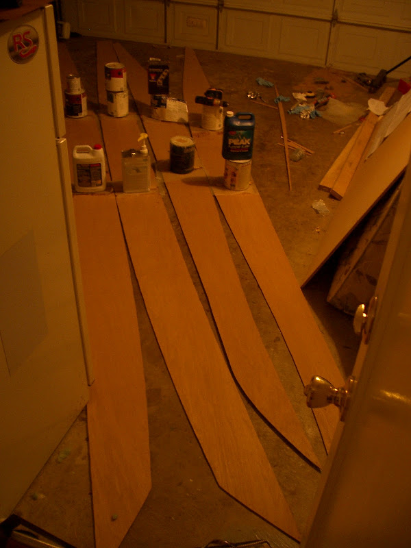

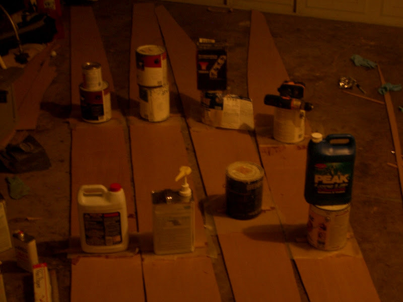

While the pieces were still screwed together I finished drilling the stich holes, smoothing the edges and butt joining all my pieces together for the bottom and side planks...
I wanted to glue them up on top of each other so both sides were 100% identical and I didn't want to wait for the glue to dry to do so. Instead, I did the following:
1. Line up Straight line copied from plans on bottom port plank
2. Butt panels, apply adhexive and screw in butt block with temporary deck screws (I didn't mind doing this since my bottom and sides will be mostly painted)
3. Flip plank over onto wax paper to protect ground and prevent it from sticking to the ground
4. Apply another sheet of wax paper over the back (inside of actual boat)port panel butts
5. Align starbord plank with the help of protruding screws from port side, which are now sticking point up
4. Apply glue and screw butt block to starboard plank. The screws might barely hit the port plank beneath, but again I din't mind since I am painting most of the bottom and side.
5. Flip the planks back over so outside of butt down to the ground
6. Put a thin strip of wood over the joint and apply pressure to keep it all tight in case the screws didn't put enough pressure.
I hope that made sense and was helpfuly to someone, and I hope it wasn't in the instructions. I tend to not read instructions sometimes
Stitching to come tommorow morning!

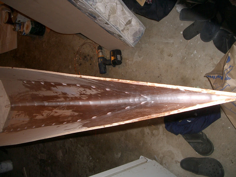

Day 4:
I finished all the stitching of the bulkheads, chines and sheers.
I saw a technique on another builders site that shows him using small blobs of epoxy "tacks", kind of like welding...
I epoxied some of the deep areas at the bow and stern that will need two thinner buildups, and I "tacked" alot of the rest of the panels together.
I will come back tonight and remove the stitches, clean, sand and to add the full fillets to all the joints.
I also read that you should fillet first, then when the fillet is starting to set up you should pre-saturated the glass on a sheet of plywood, then lay the freshly saturated glass into the slightly tacky fillet to avoid having to sand.
I think i'll try that and let you all know how it goes.
Here's the ugly fillets at the bow that I will have to clean and sand (just to abrade) and then lay a nice smooth fillet overtop of it. The blobs are where the epoxy built up under the wire stitches, and I plan to lay the final fillet to about that thickness, then cover with glass.

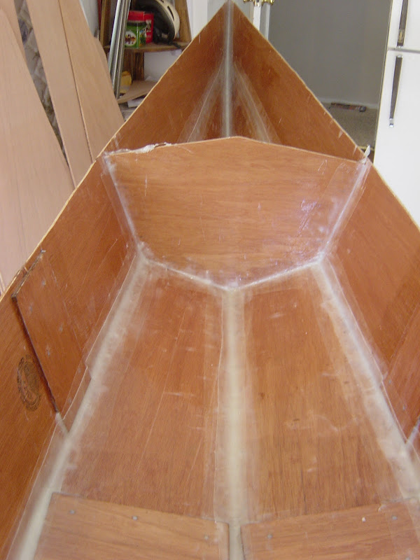

Day 5:
I went to work this morning and the boss told me to take off so I got a good 8 hours in today.
I filleted the keel, chines, sheers, and with the first lamination of fiberglass. What a messy process! I must have gone through about 50 pairs of harbor freight nitrile gloves, a gallon of epoxy, and 2 cans of West system adhesive filler (406?).
And, my camera broke so no pictures today. Trying to find a charger for the old one and maybe have pics tomorrow...
I guess tomorrow I am going to have to lay the 3" tape over the 4" tape I laid down today. I really don't want to though, it's a sloppy sloppy process.

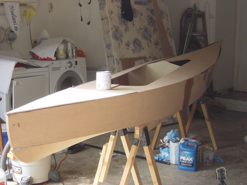

Day 6:
I had to take a break to fix my jeep, but I got the final interior taping done.
West Marine didn't have 3" tape, so I used 2" tape instead, but the joints seem nice and strong now.
I have the deck panels all cut, and I can tell it's going to be a bear to get them to fit. It was really hard tracing the longer thin pieces due to the paper shifting, but I think the are close enough. Taking today off and i'll coat the undersides of the decks tomorrow night, then fitting the panels and deck plates and taping the underside of the deck as much as possible.

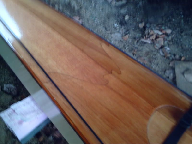

it's a bit of a crappy picture, but here's my gunwale treatment...
The sides and bottom are painted a cream colour. The deck is "bright", and the gunwale strips are 1" x 1/4" western red cedar, rounded, and fastened with bronze ring nails (more for show, than anything else).
The black lines are just safety "grab ropes".
I've seen plywood 'yaks where they paint about 1" of the deck and the sides, as you describe. they look great.
Another option might be some brass or chrome rubrail trim... but then you need to deal with the points.
I've never taped the inside seams, but a book I have describes the process. They recommend the "paintbrush on a stick" to extend your reach. Also a head lamp. Also GOOD VENTILATION. (be careful in there)
